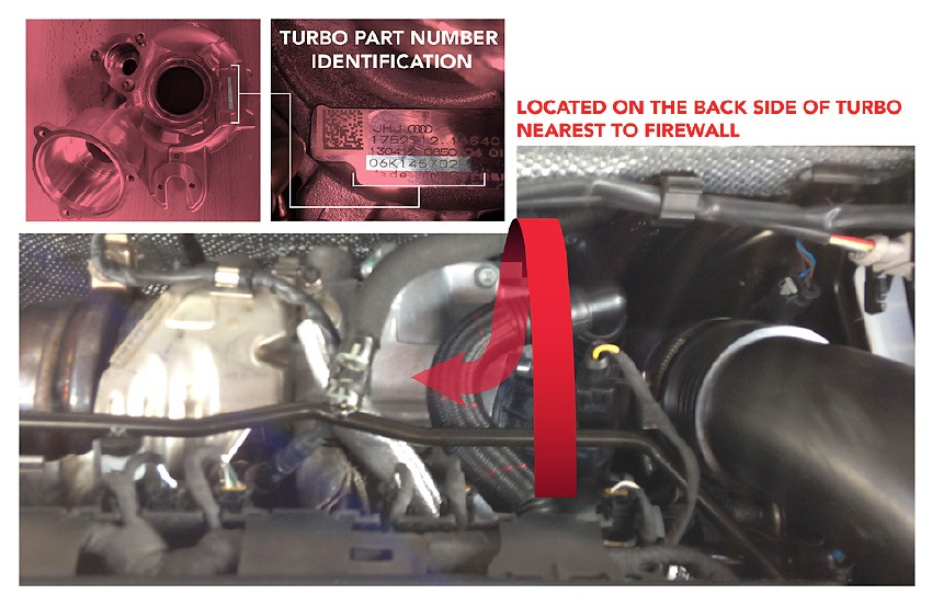

как смотреть номер турбы
бюллетень по ауди

Post subject: Re: R mk7 Turbo failure!PostPosted: 05 Aug 2014, 22:52
VAG issued a new campaign this morning replacing all of the old turbocharger part numbers because turbos were failing from the factory on unmodified cars. This includes turbos that haven't failed yet, so they are simply being proactive and replacing the turbo before there's an issue.
Here's one of the document released this morning:
www.goapr.com/support/tsb/21e7.pdf
I also was sent one from Europe from Volkswagen so I'm assuming we'll see more of these popping up to cover all models. They're probably covering their bases and making sure they have enough turbos on hand. The parts depo is apparently loaded with turbos at the moment.
Here's how you can find the turbo part number to see if you have a unit they are replacing:
Zoom in (real dimensions: 850 x 553)Image
Here are the turbo part numbers that fail from the factory on unmodified cars:
06K 145 702 K — Revision 1
06K 145 702 Q — Revision 2
06K 145 702 R — Revision 3
New turbo part number to fix failures:
06K 145 702 T — Revision 4
I'd highly suggest getting this update!

По фото видно что хрен туда подлезешь номер посмотреть
