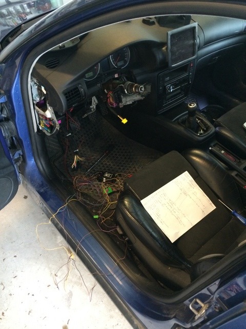

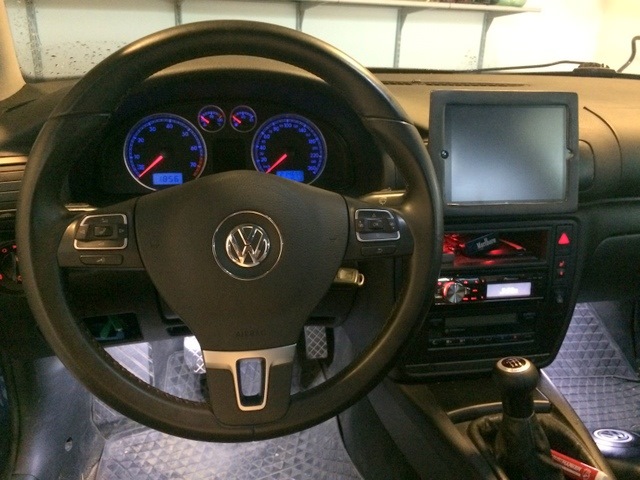

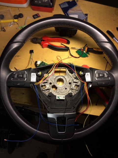

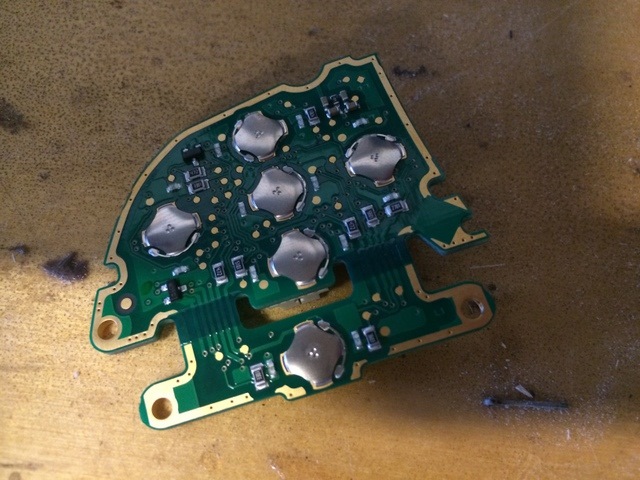

Wheel is from Golf 6 and has MF controls. The buttons will be controlling the radio (volume, next, previous), cruise control (set, -, +, res, cancel), and MFA (next, previous, trip1, trip2).

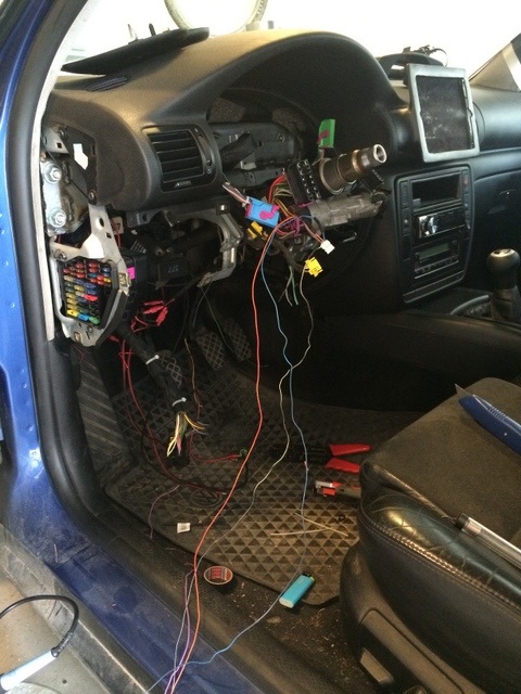

Lots and lots of headache but finally got the steering wheel buttons working. Only thing left is MFA controls and button illumination.

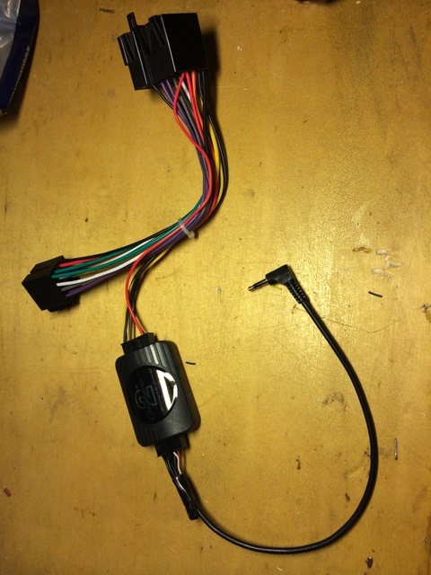

I ordered connects2 adapter for pioneer headunit so my buttons work with that.

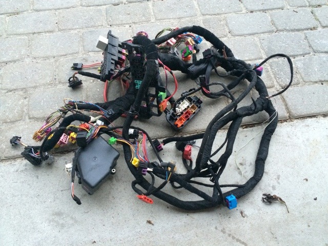

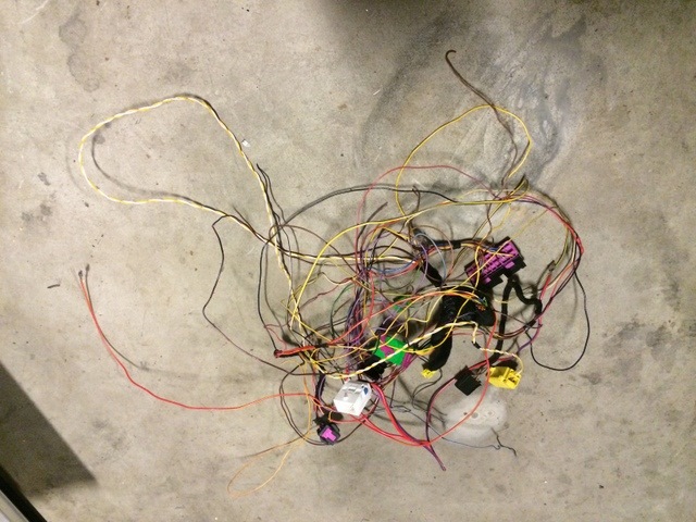

I had to get a whole wiring loom to sort out what wires I need to install to make it work and I made whole new buttons to control my original B5 button plates.

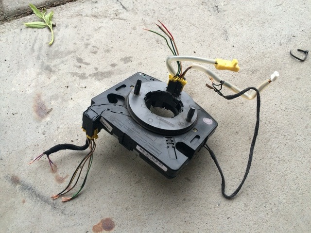

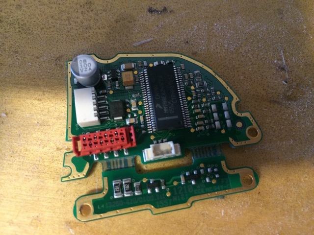

руль симптоматика))) есть одна вопрос последний фото подушка безопасности без как мешай контактов?
Right now the contact boards are wrapped in tape so no problem there.
