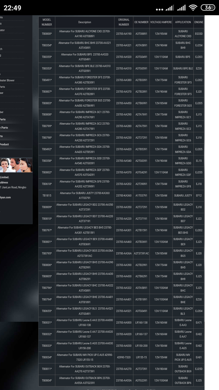

www.tocean.com.cn/product.asp?id=2630&type=233 ссылка на сайт с табл цей
MODEL NUMBER
Description
ORIGINAL NUMBER
OE NUMBER
VOLTAGE/AMPERE
APPLICATION
ENGINE
TB0800*
Alternator For SUBARU ALCYONE CXD 23700-AA190 A3T08891
23700-AA190
A3T08891
12V/95AM
SUBARU ALCYONE CXD
EG33D
TB0354*
Alternator For SUBARU BHC BH9 23700-AA321 A3TA5891
23700-AA321
A3TA5891
12V/90AM
SUBARU BHC BH9
EJ254
TB0355*
Alternator For SUBARU BP5 23700-AA520 A3TG0491
23700-AA520
A3TG0491
12V/110AM
SUBARU BP5
EJ203
TB0353*
Alternator For SUBARU BPE BLE 23700-AA510 A3TG0591
23700-AA510
A3TG0591
12V/110AM
SUBARU BPE BLE
EZ30
TB0491*
Alternator For SUBARU FORESTER SF5 23700-AA380 A2TB3091
23700-AA380
A2TB3091
12V/75AM
SUBARU FORESTER SF5
EJ202
TB0807*
Alternator For SUBARU FORESTER SF5 23700-AA370 A2TB2891
23700-AA370
A2TB2891
12V/90AM
SUBARU FORESTER SF5
EJ20
TB0803*
Alternator For SUBARU FORESTER SG5 23700-AA450 A2TB6991
23700-AA450
A2TB6991
12V/85AM
SUBARU FORESTER SG5
EJ205
TB0808*
Alternator For SUBARU IMPREZA GC1 23700-AA290 A2TA7691
23700-AA290
A2TA7691
12V/75AM
SUBARU IMPREZA GC1
EJ15
TB0799*
Alternator For SUBARU IMPREZA GC2 23700-AA280 A2TA7591
23700-AA280
A2TA7591
12V/70AM
SUBARU IMPREZA GC2
EJ15
TB0798*
Alternator For SUBARU IMPREZA GC6 23700-AA230 A2T37291
23700-AA230
A2T37291
12V/85AM
SUBARU IMPREZA GC6
EJ18
TB0492*
Alternator For SUBARU IMPREZA GDA 23700-AA420 A2TB5391
23700-AA420
A2TB5391
12V/75AM
SUBARU IMPREZA GDA
EJ205
TB0358*
Alternator For SUBARU IMPREZA GDD 23700-AA540 A2TG0391
23700-AA540
A2TG0391
12V/90AM
SUBARU IMPREZA GDD
EL15
TB0802*
Alternator For SUBARU IMPREZA GDF 23700-AA570 A3TG4291
23700-AA570
A3TG4291
12V/110AM
SUBARU IMPREZA GDF
EJ255
TB0618*
Alternator For SUBARU IMPREZA GF8 23700-AA202 A2T39091
23700-AA202
A2T39091
12V/75AM
SUBARU IMPREZA GF8
EJ18
TB1815
Alternator For SUBARU JUSTY 23700-KA360 A1T03791
23700-KA360
A1T03791
12V/55AM
SUBARU JUSTY
EF12
TB0809*
Alternator For SUBARU LEGACY BD2 23700-AA350 A2T37291
23700-AA350
A2T37291
12V/85AM
SUBARU LEGACY BD2
EJ18
TB0810*
Alternator For SUBARU LEGACY BD7 23700-AA220 A2T37191
23700-AA220
A2T37191
12V/80AM
SUBARU LEGACY BD7
EJ22
TB0797*
Alternator For SUBARU LEGACY BE5 BH5 23700-AA301 A2TB1591
23700-AA301
A2TB1591
12V/90AM
EJ202
TB0801*
Alternator For SUBARU LEGACY BE9 23700-AA460 A3TB3691
23700-AA460
A3TB3691
12V/100AM
SUBARU LEGACY BE9
EJ25
TB0795*
Alternator For SUBARU LEGACY BG5 23700-AA36A A2T37391AC
23700-AA36A
A2T37391AC
12V/85AM
SUBARU LEGACY BG5
EJ20
TB0806*
Alternator For SUBARU LEGACY BH5 23700-AA390 A2TB2991
23700-AA390
A2TB2991
12V/75AM
SUBARU LEGACY BH5
EJ20
TB0805*
Alternator For SUBARU LEGACY BH9 23700-AA430 A2TB6291
23700-AA430
A2TB6291
12V/75AM
SUBARU LEGACY BH9
EJ25
TB0796*
Alternator For SUBARU LEGACY BHC 23700-AA322 A3TA5891
23700-AA322
A3TA5891
12V/100AM
SUBARU LEGACY BHC
EJ25
TB0794*
Alternator For SUBARU LEGACY BHE 23700-AA401 A3TB1891
23700-AA401
A3TB1891
12V/100AM
SUBARU LEGACY BHE
EZ30
TB0655*
Alternator For SUBARU LEGACY BL5 23700-AA521 A3TG0491
23700-AA521
A3TG0491
12V/110AM
SUBARU LEGACY BL5
EJ204
TB0031*
Alternator For SUBARU Leone E-AA3 23700-AA000 LR160-138
23700-AA000
LR160-138
12V/60AM
SUBARU Leone E-AA3
EA71
TB0032*
Alternator For SUBARU Leone E-AA7 23700-AA020 LR160-137
23700-AA020
LR160-137
12V/60AM
SUBARU Leone E-AA7
EA82
TB0033*
Alternator For SUBARU Leone E-AG5 23700-AA030 LR150-200
23700-AA030
LR150-200
12V/50AM
SUBARU Leone E-AG5
EA82
TB0034*
Alternator For SUBARU MV PICK UP E-AU5 42990-7320 LR155-15
42990-7320
LR155-15
12V/55AM
EA81
TB0811*
Alternator For SUBARU OUTBACK BG9 23700-AA270 A2T37391
23700-AA270
A2T37391
12V/80AM
SUBARU OUTBACK BG9
EJ25D
TB0804*
Alternator For SUBARU OUTBACK BP6 23700-AA55A A3TG2391
23700-AA55A
A3TG2391
12V/100AM
SUBARU OUTBACK BP6
EJ25
