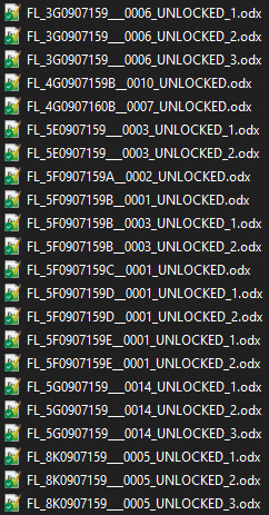

Since I'm getting a lot of messages on a daily basis if I can share some unlocked soundaktor firmwares, I decided to release them on my Github page so everyone can download them for free.
Download the unlocked firmwares here.
Now you can finally make your car sound like it's an RS4 on the inside! Make sure you read the entire page, so you don't brick your hardware when flashing.
If you have any soundaktor firmware (xxx-907-159 or xxx-907-160) which isn't on the list yet, please share it with me so I can make it work for all cars and engines! I'm especially looking for Porsche firmware, which seems hard to come by… Enjoy, and please let me know which is your favorite!

already unlocked 12E035335B myself, thanks for the detailed description (FL_12E035335B__0006_UNLOCK.odx)

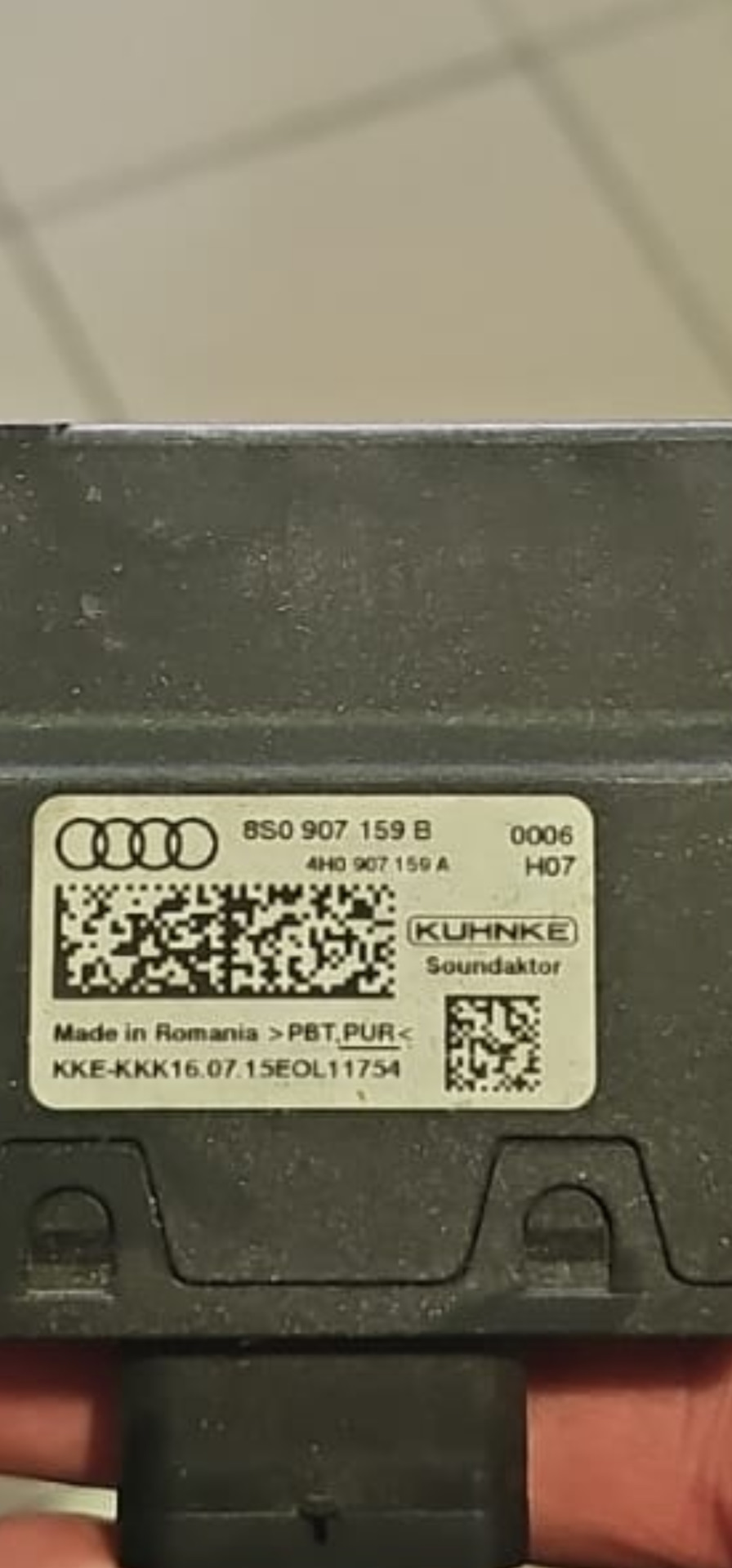

Hello, my friend's VW e-UP with factory-installed Soundaktor (SW: 12E 035 335 B HW: 4G0 907 160 B) has an error "0005 — Incorrect vehicle type" in the ECU. Could you unlock this firmware?

Can i flash this to my module ?
FL_8S0907159___0004

thanks for the files, but how to download?
Click the download links in the table on the page ;-)
