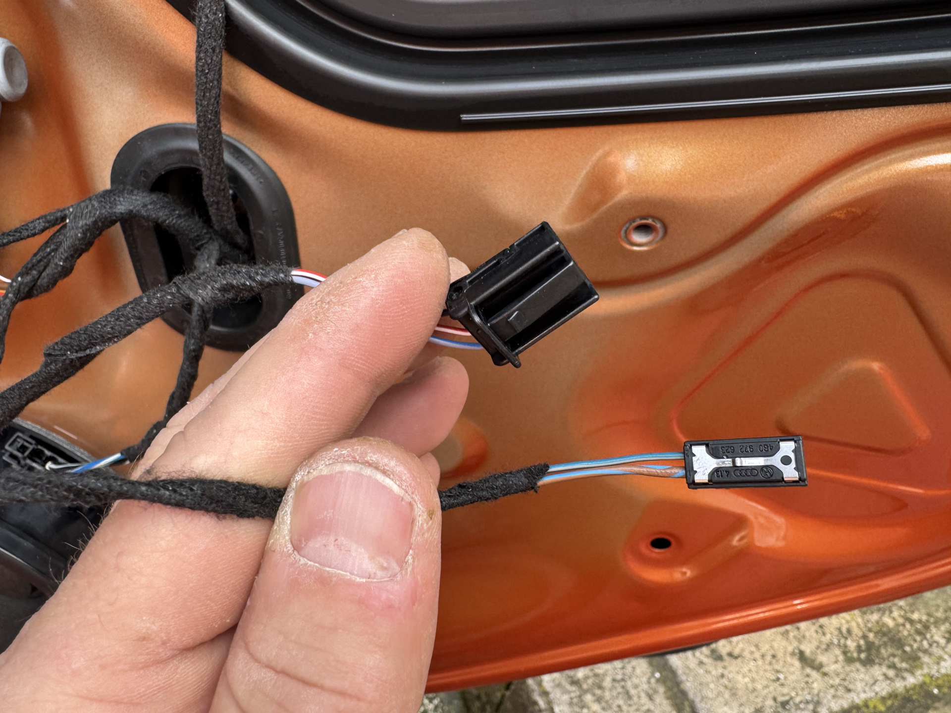

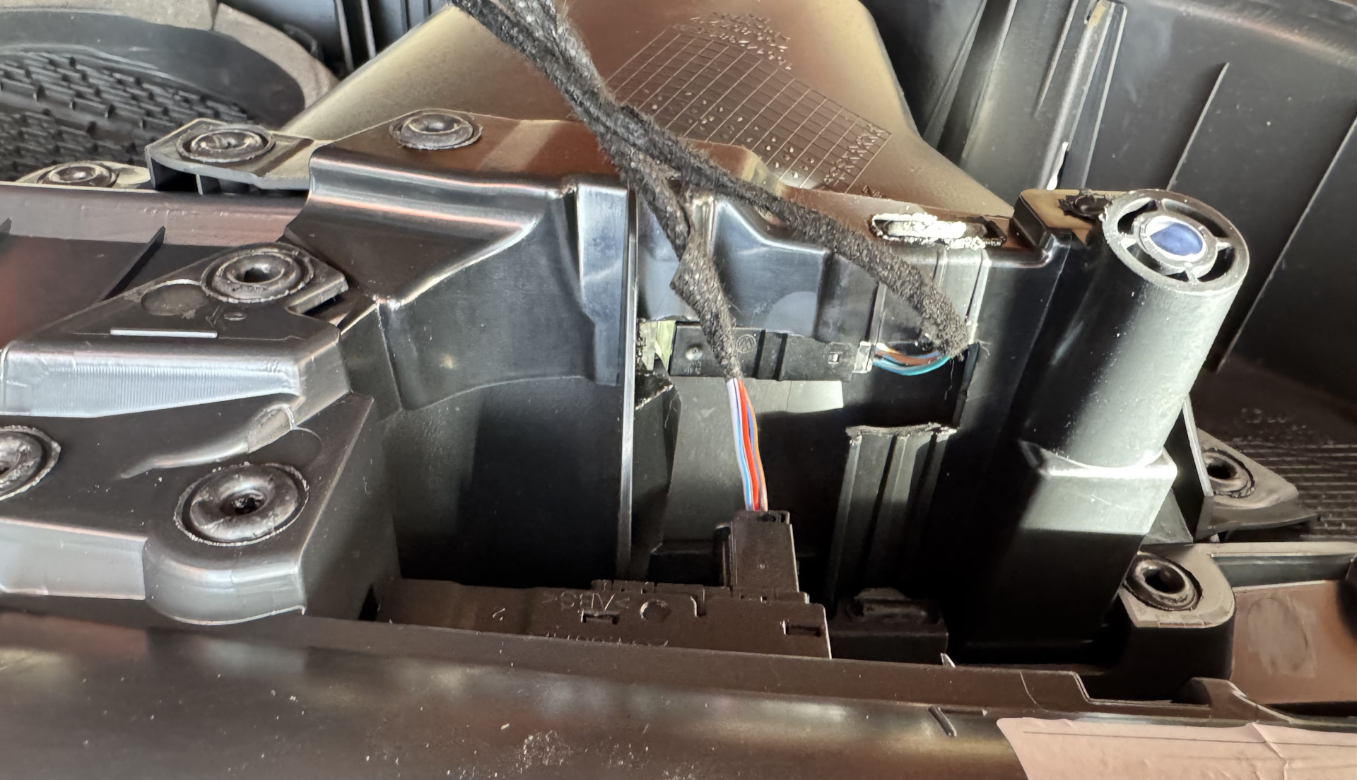

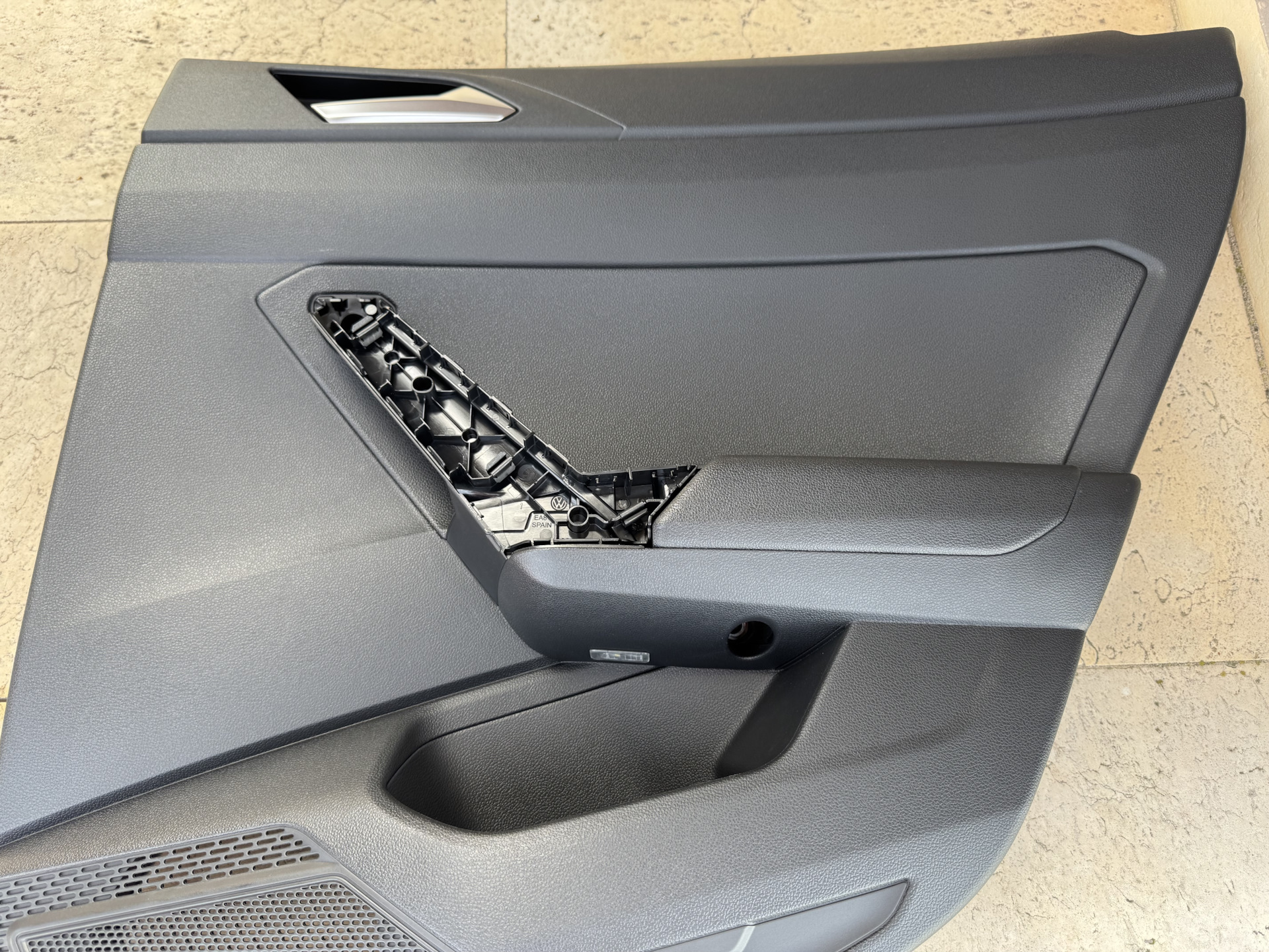

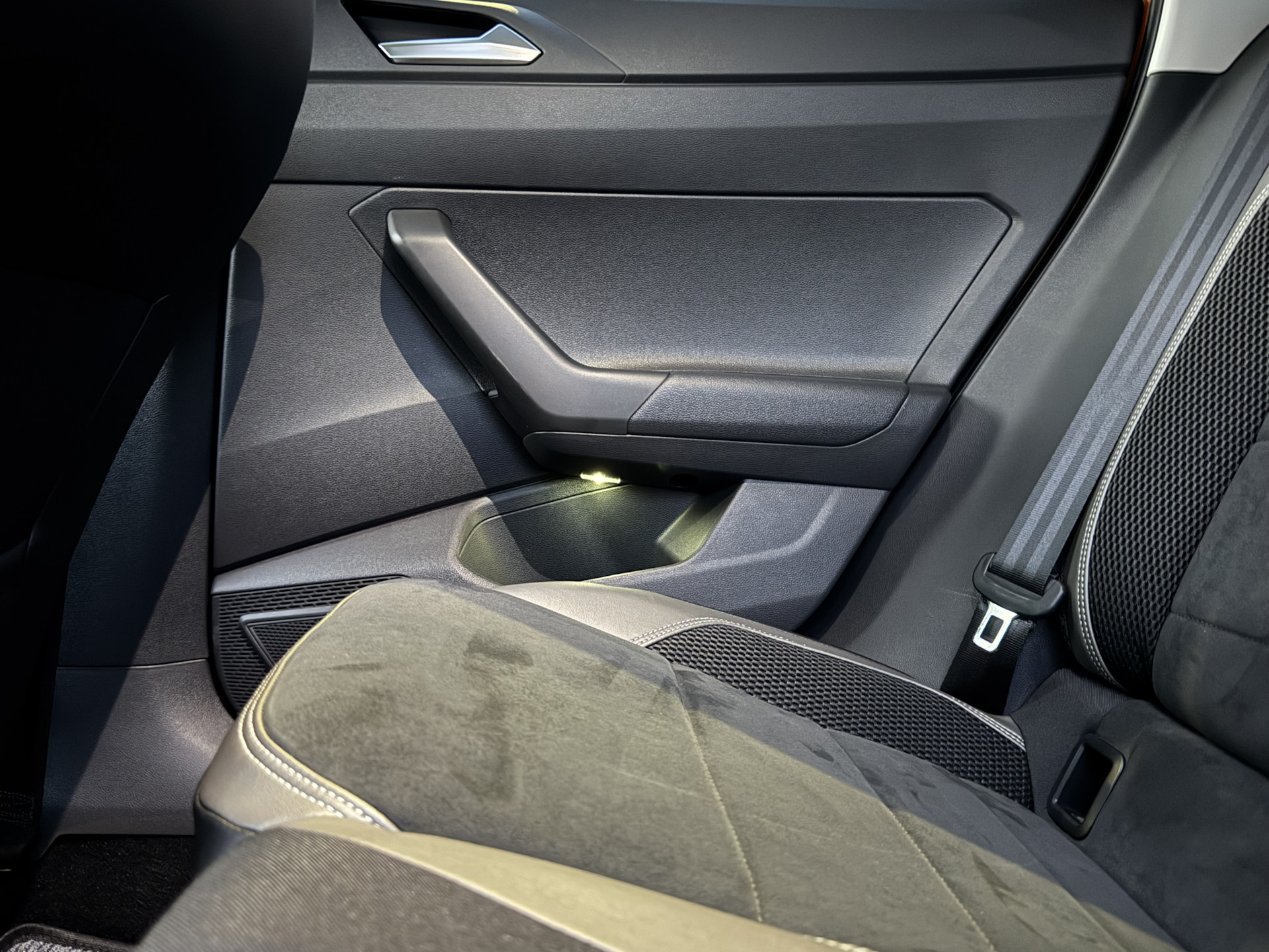

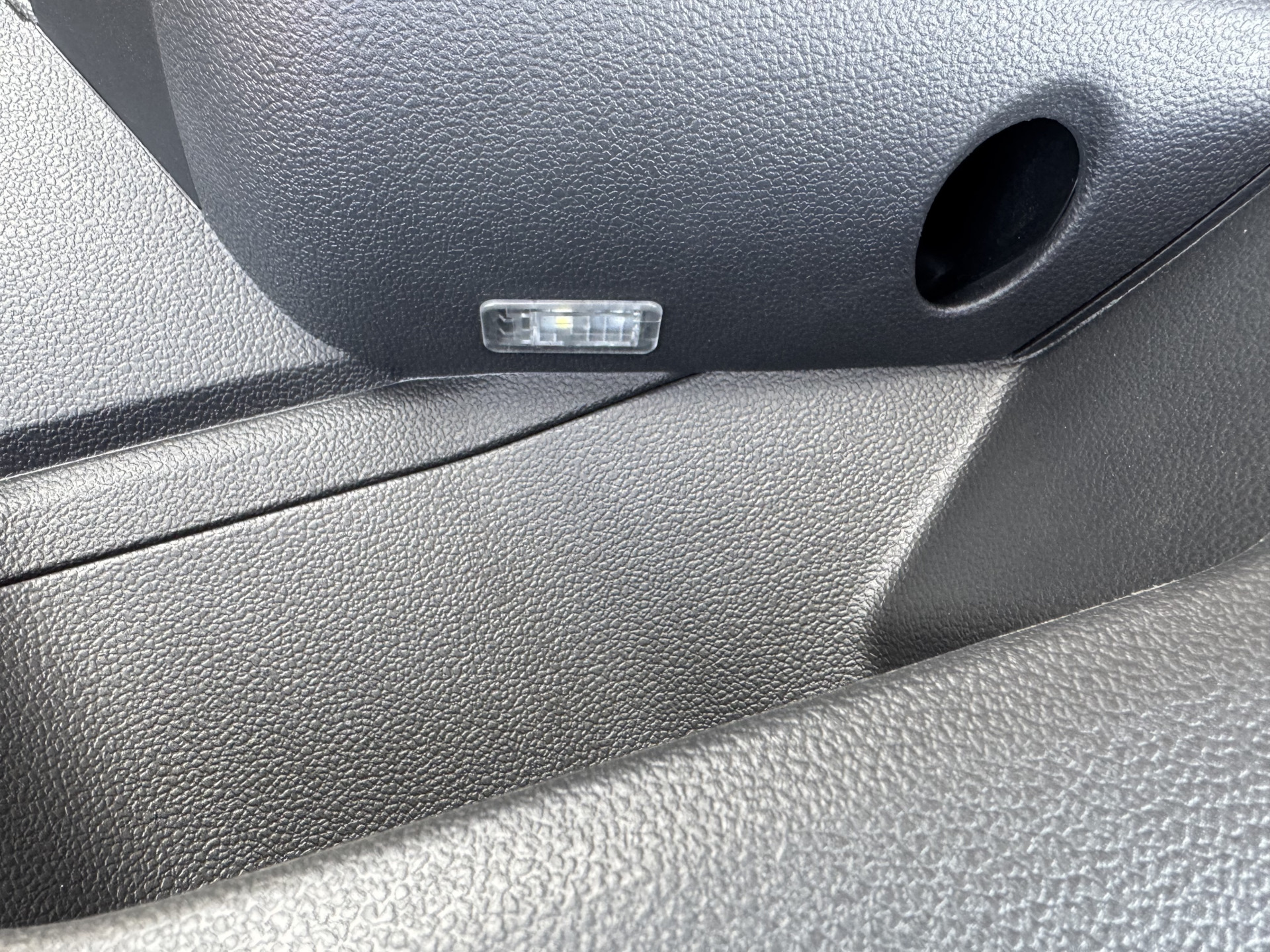

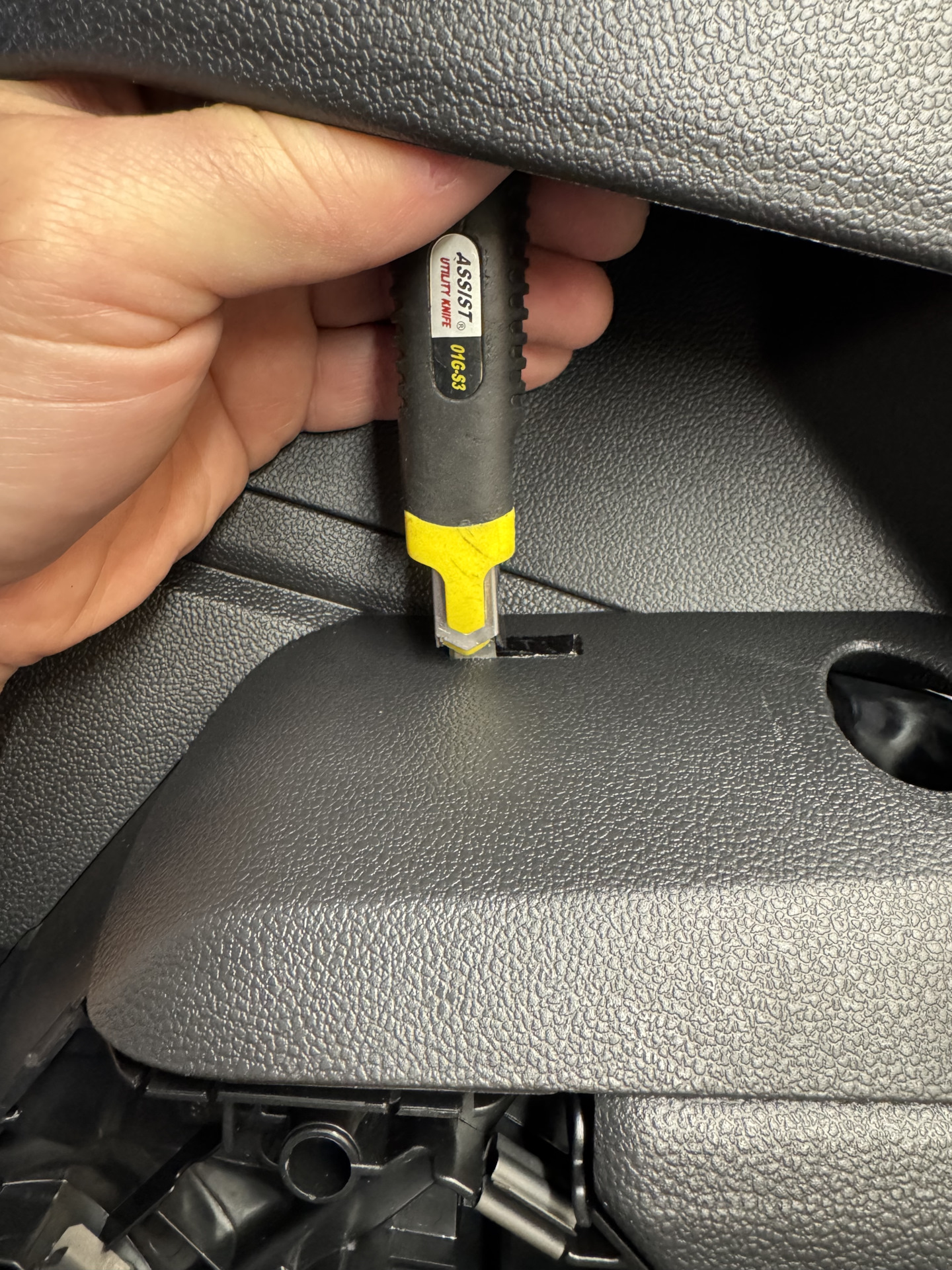

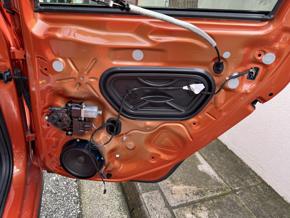

It was time for rear pockets mod 😉

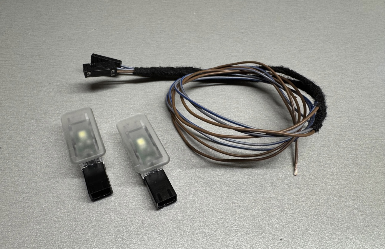

The 5TA947409 is perfect for rear door panels too.
Same cut as the front doors, + and — from window button and mod done 😁
