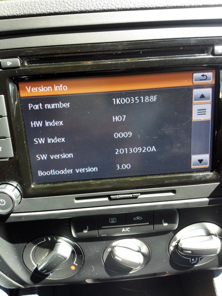

Hmmm, i have an issue with my RCD 510 sometimes it takes up to 10 minutes to power on . Sometimes instant. what can be wrong, there is no CD inside, 1st i though it's caused by stuck CD once it powered on i removed all CDs and this happened again 2 times…
whats your rcd510 SW and HW version?
H07
SW 0009
SW version 20120920a
bootloader 3.00
VAG-COM-PERM
may be you can try to upgrade with this file 1K0035188F_DE2_0010.sgo
We never did upgrade to 1K0035188F, so its on your own risk ^^,
you think this is a software issue?
May be HW problem

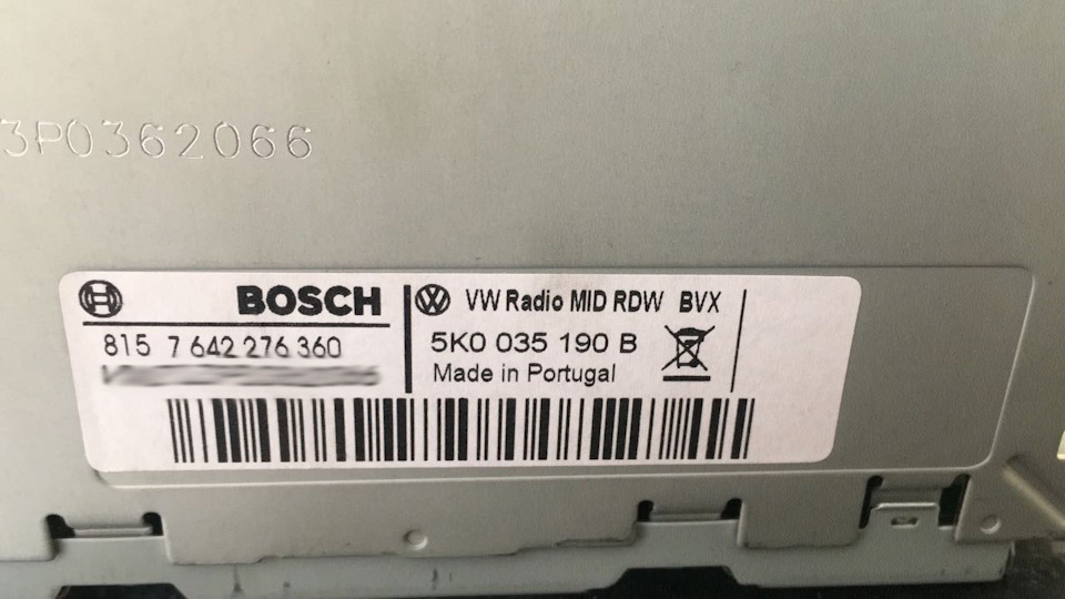

Do you know if 5k0 035 190 B have sound scheme too? I have one in new state here.
5K0 035 190 B has sound scheme, but please check it before purchase
Thanks! I found it on drive2: www.drive2.ru/l/4004656/
And he have:
Part No SW: 5K0 035 190 B HW: 5K0 035 190 Bed and
the Component: Radio RCD510 005 0236
I'm bought this unit from image, maybe everthing will be ok eheheh. I will wait it to test :) Many thanks about your help.
