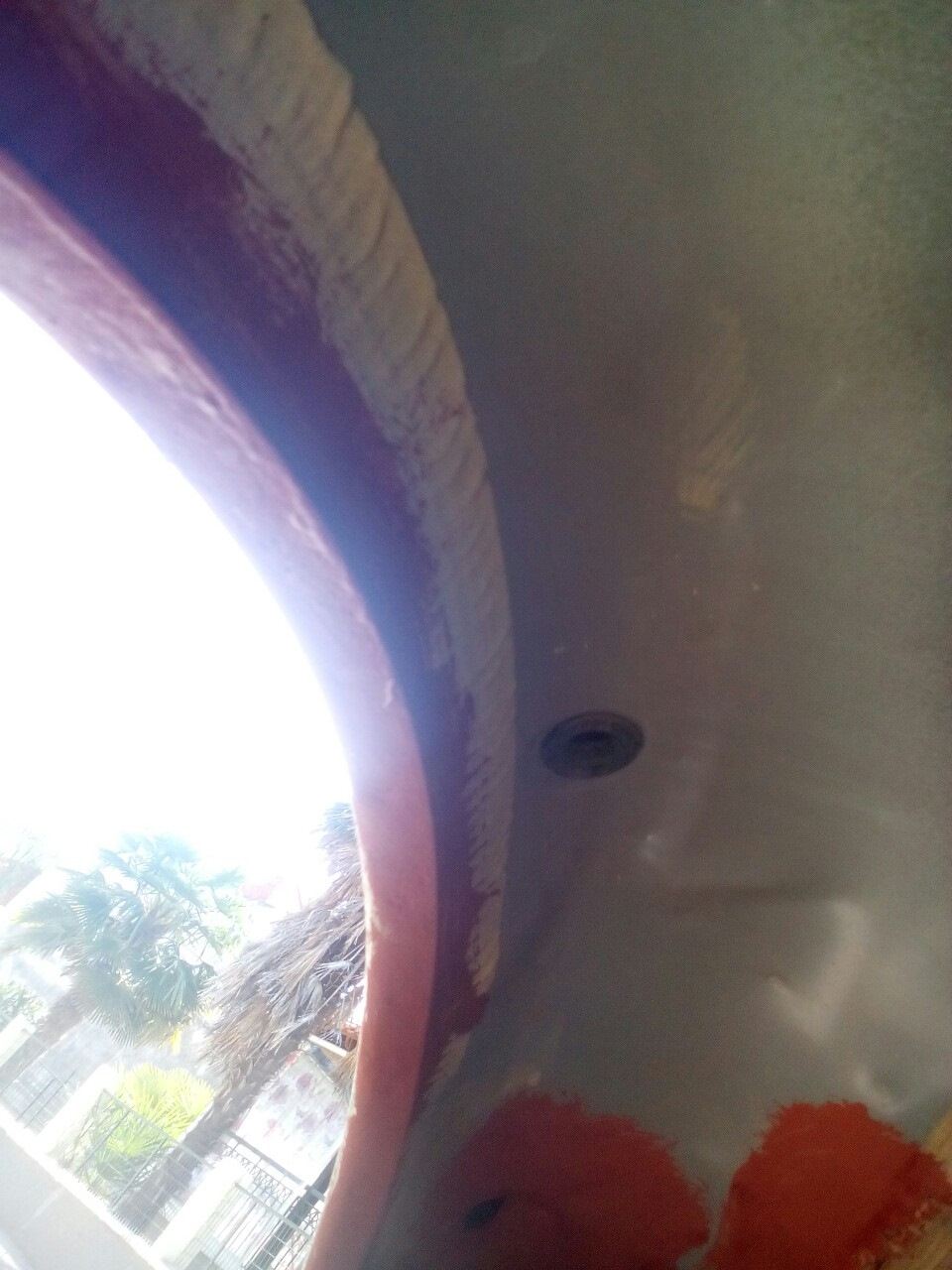

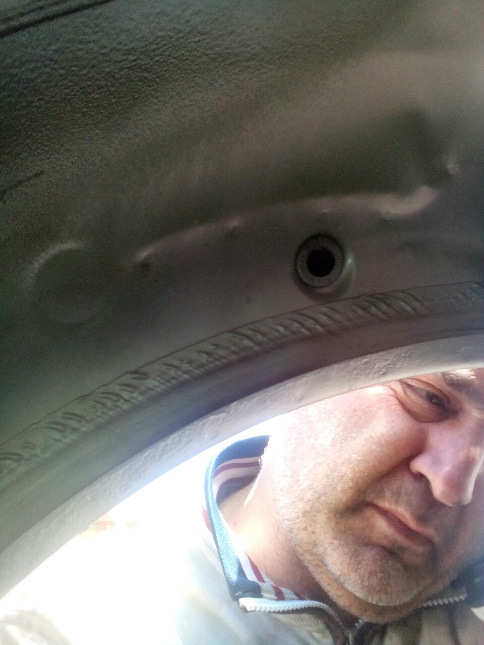

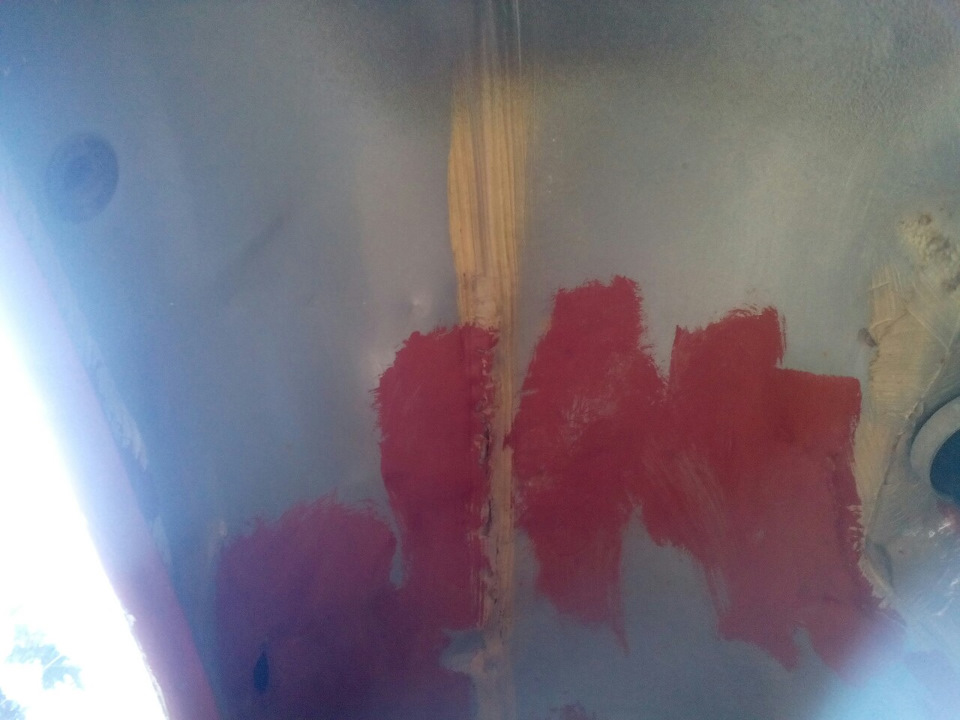

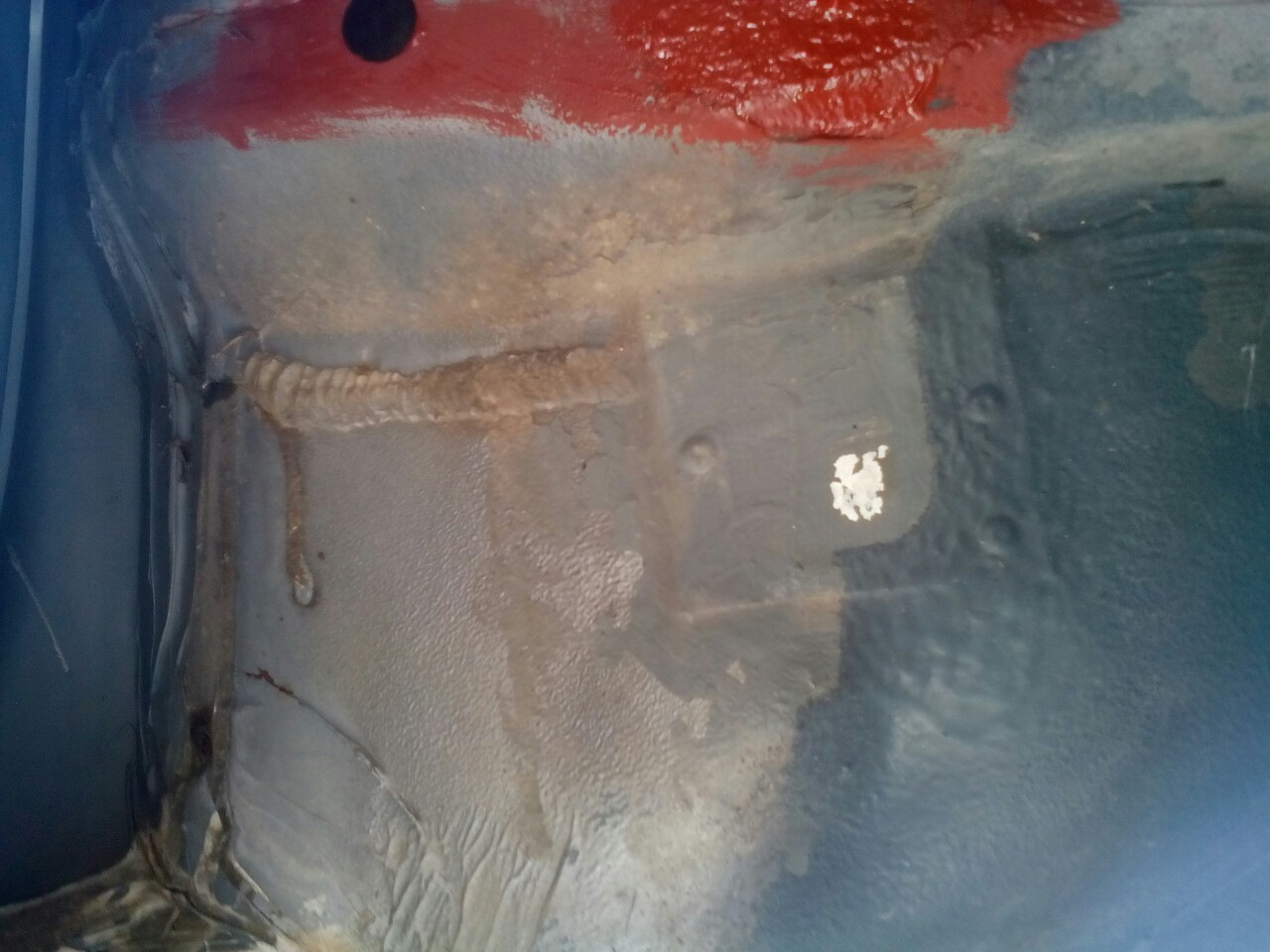

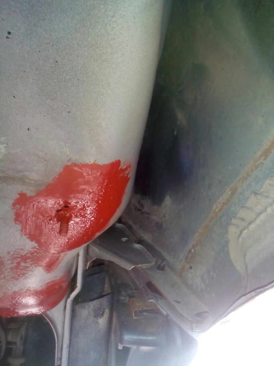

Hi, in greece we don't see snow often. So normally body is without rust. Last year, and this year, i didn't remove plastic dust covers from underwheels. So, i started, to remove ALL wheels, and plastic underwheel covers to find if rust is going bigger.
Let's find out!
for example, every wheel arch had a lot of dust, sand, salt,
1. clean them ALL with water pressure.
2. sand paper the rust places.
3. red color anti-rust protector.
4. silver spray color
5. clear varniss gloss spray.
work was 8 hours.
