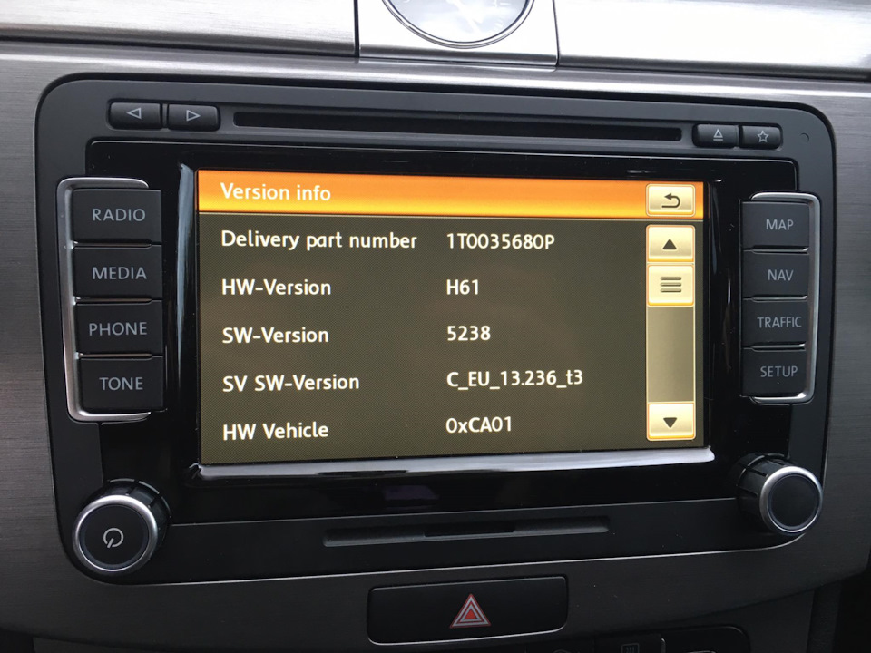

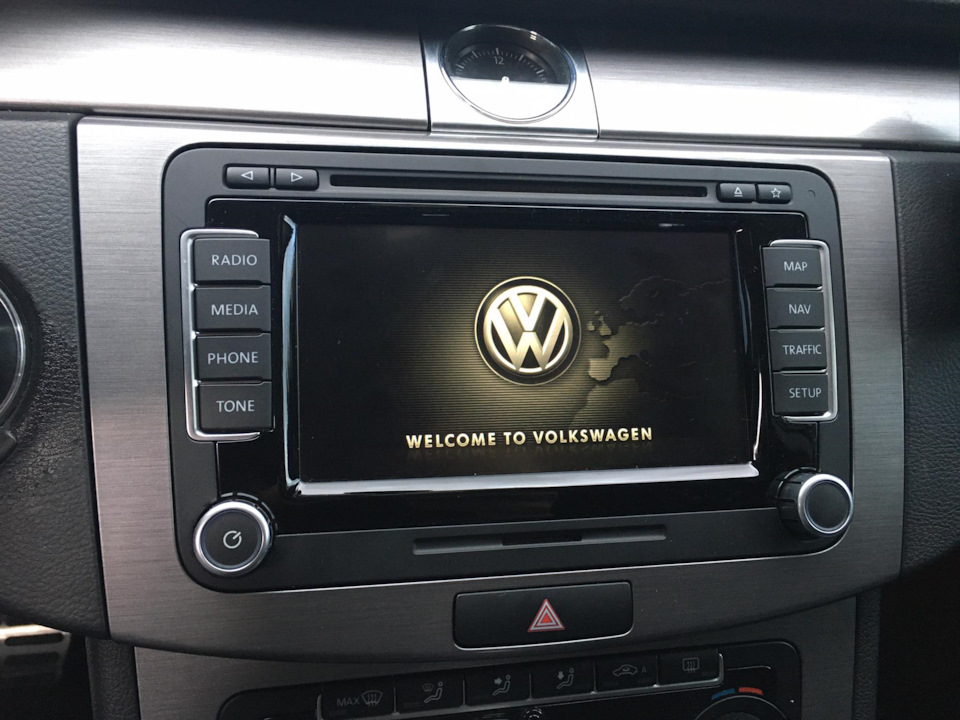

I bought radio with software 3970.
The radio responded slowly and did not have radiotext support.

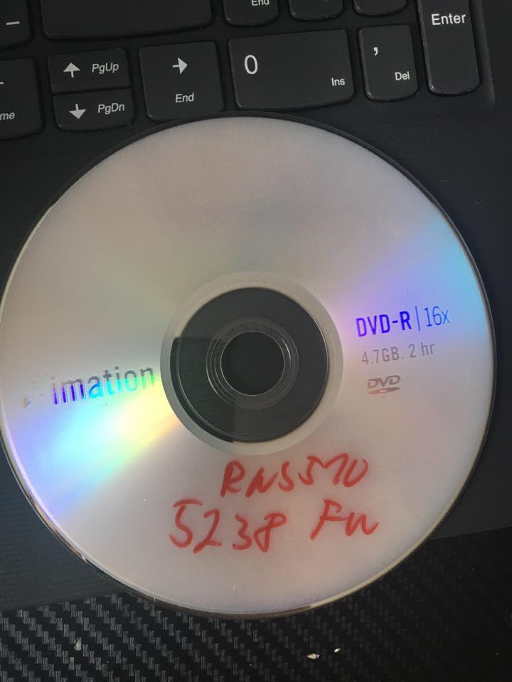

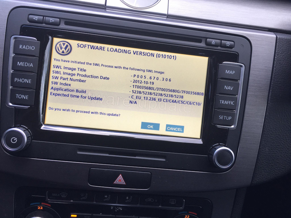

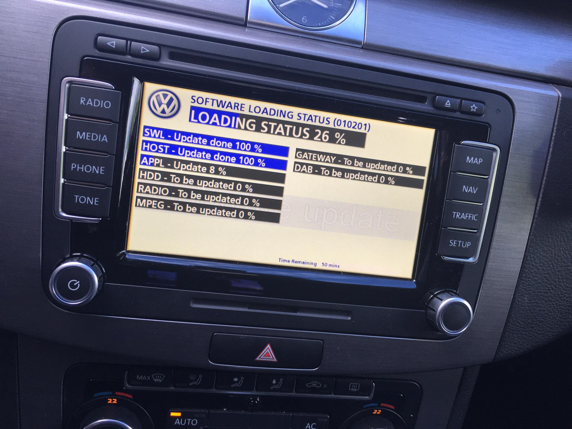

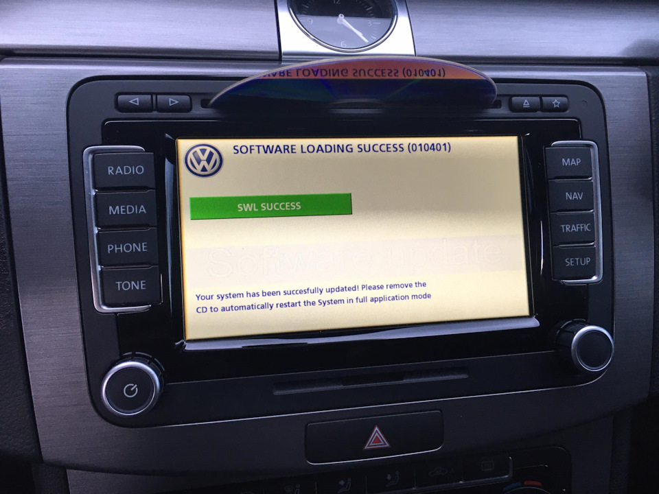

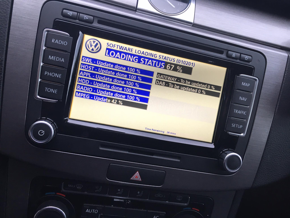

I downloaded and burned the software 5238.
Запчасти на фото: 1T0035680L, 7F0035680B
Запчасти на фото: 1T0035680P
I took the information from — www.drive2.ru/l/465526077448520463/

Do you need to setup with VSDC after update?
I just updated software and the encoding remained
