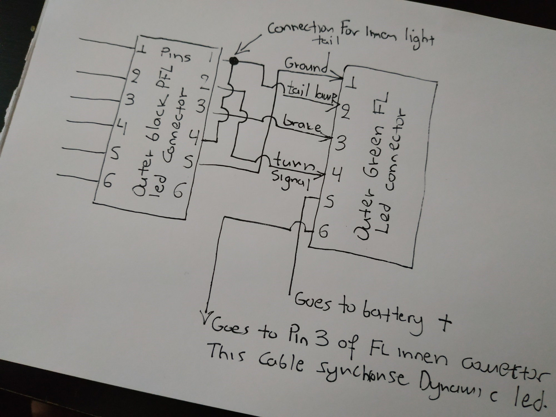

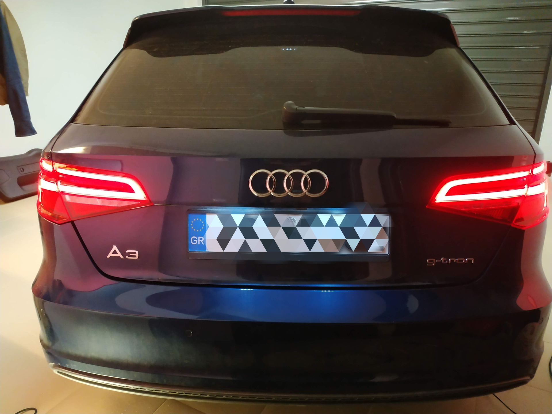

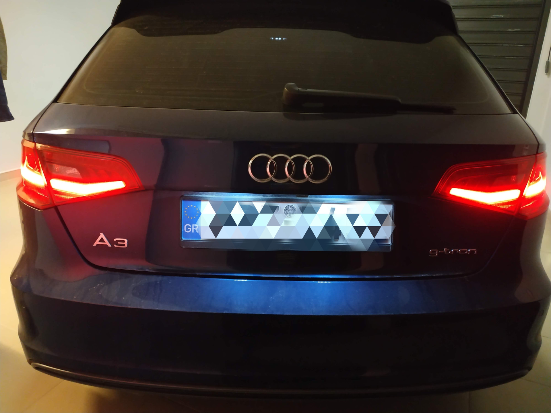

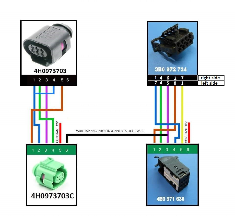

My car should have this moving turn signals so i decide to install it.

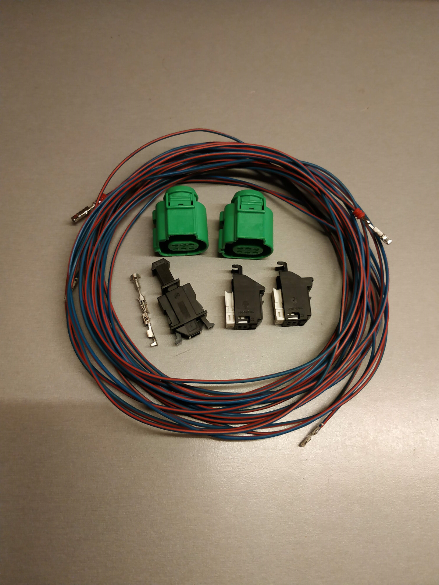

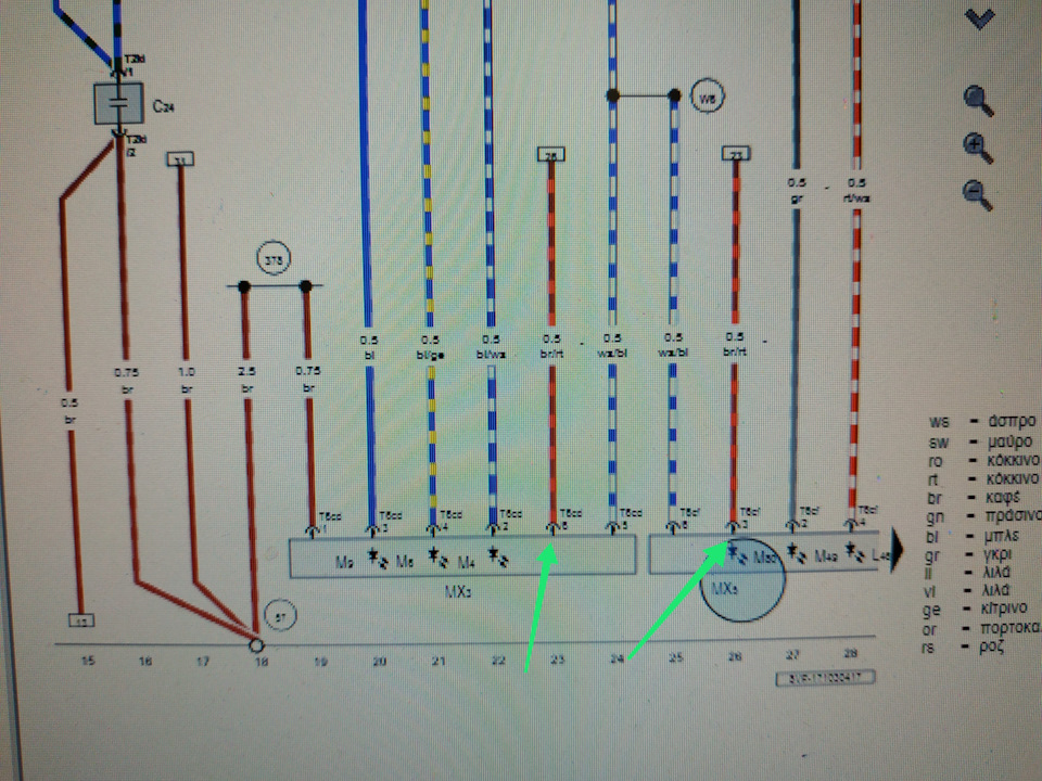

Mod was easy because my car had factory PFL led tail lights so no coding nedded. At the outer connector i connect 1&4 cables ( this send illumination to innen light ), connect the outer pin 6 with innen pin 3 ( this sunchonise the outer and the inned tail lights, for the dynamic turn signal) . Finaly outer pin 5 and innen pin 6 straight to +12 volt ( for dynamic work)

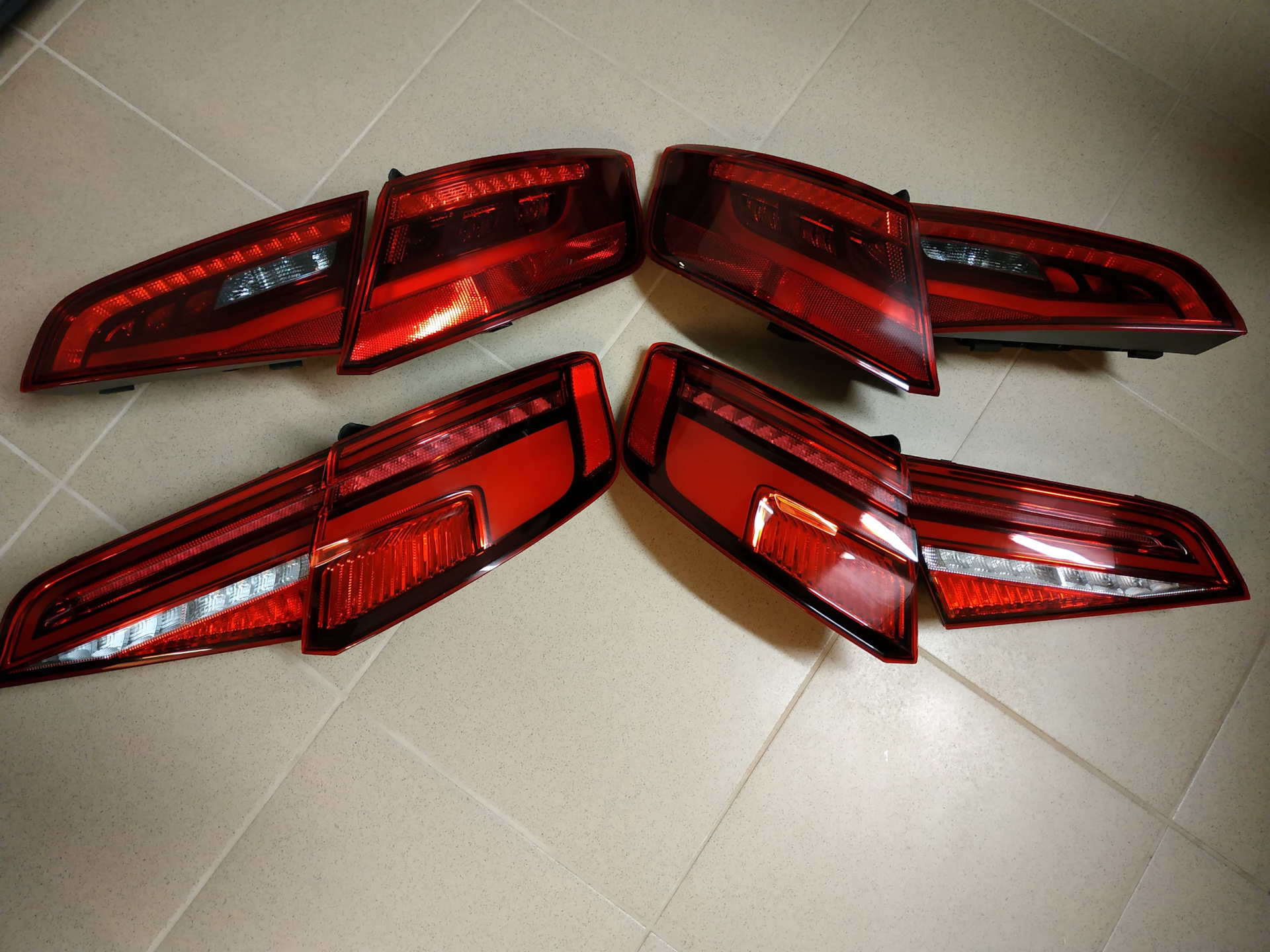

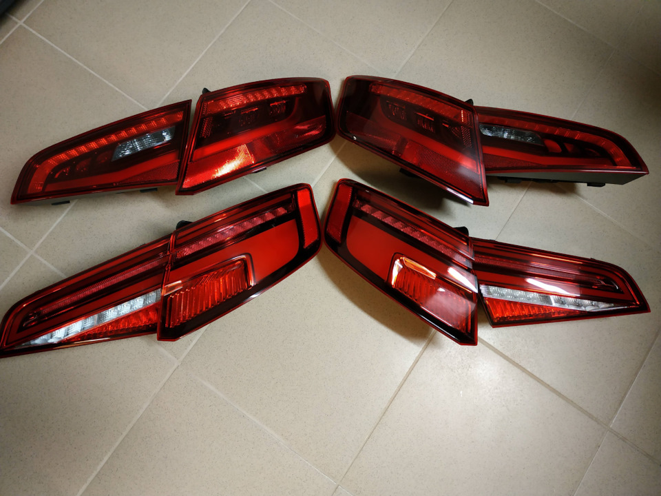

Ebay help me to find tail lights from Uk. Order from dealer the connectors for new lights and installation was easy.
Only wiring work have done, no codding because my car has led tail lights .

I made wiring

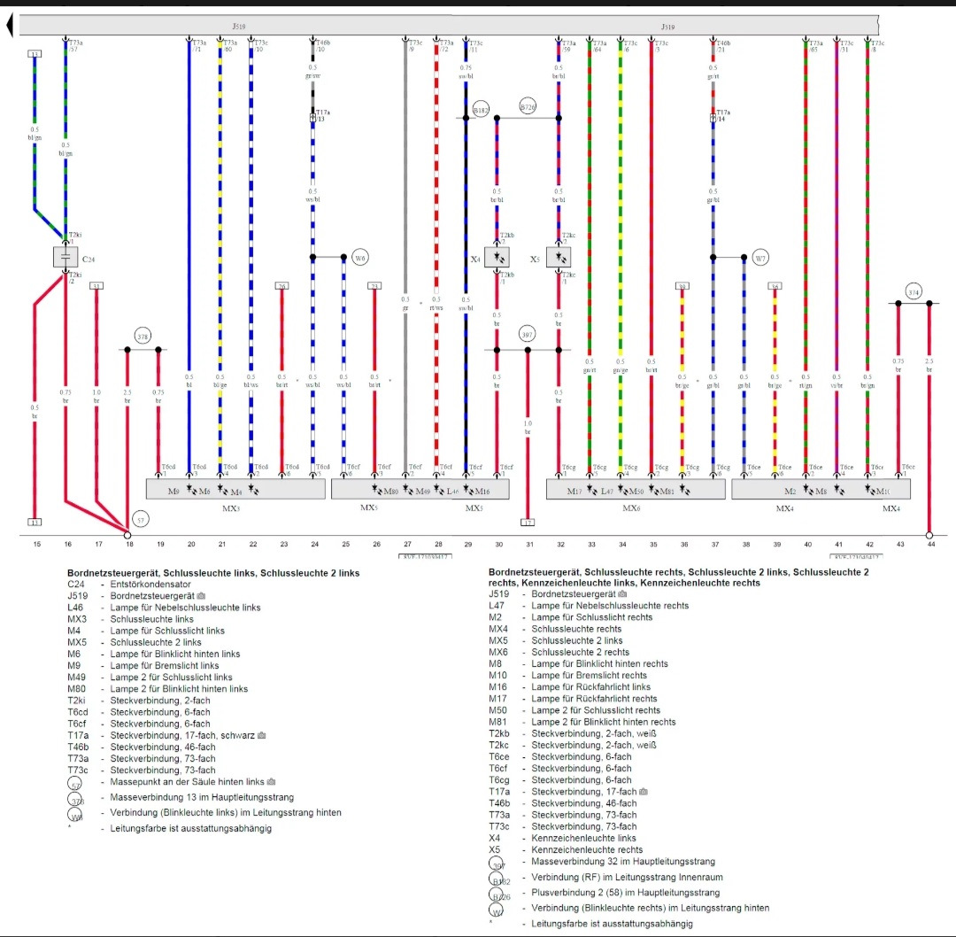

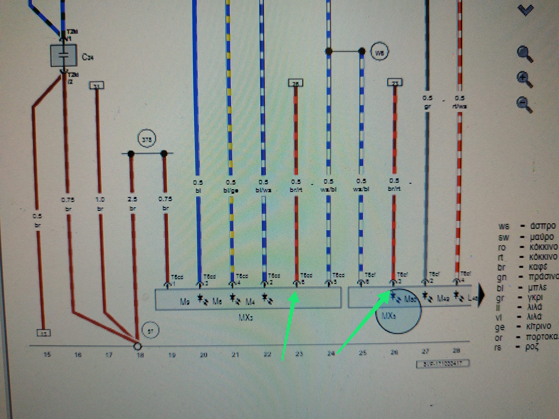

Where did you get constant 12V for dynamic blinkers?
Run a cable to fuse holder, under drivers seat, and install it with 10A fuse .
Oh, an easy way (same as I did). Have you used Terminal 15 or 30?
There is another way with BCM connection, but I'm lacking info on it
I know about bcm way but i choose the easiest.
I use 30, straight from battery for all time use

I can't fnd 4H0973703C …where did you get them?
Hello, I order it from audi oem parts .
3€ each connector
Thanks for the info. For what i see we have 4H0973703 and me must change to 4H0973703C and the other is to change 3B0972724 to 4B0 971636 and do the wiring…is that?
Υes
Hello again…what is the part number of the flat housing in the middle of the wires (small one)? It is for fuse box? Thanks
It's a connector for cable connection outside boot .
If you want you can't use this .
It's for unclip boot door and all wiring be free for remove out door. ( like factory way)
Thank you. For cable u bought or you made it? The terminal for fuse box is 000 979 221 or 000 979 225 ?
