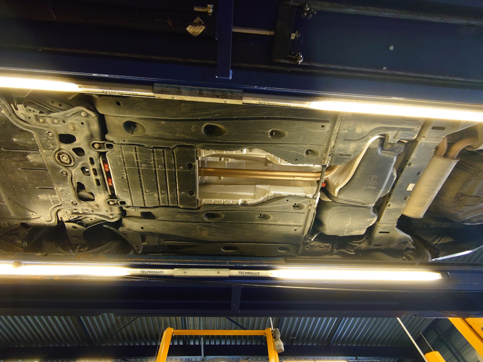

Thanks to user vivacuba, who notified me of the existence of Golf 8 aero covers for the front arms!
At first, I got the 3Q0407117 & 118, but they were a different shape:
5WA407117 and 5WA407118 are a perfect fit! Fastened with 4x 8e0825267 (n0385494 would also work)

Aero purposes, noise dampening (when stones hit this area, it doesn't sound like DING) and keeping metal out of the direct flow of road debris.
do you have some pictures of your car with all installed covers?
I'll take one, next time it's on the bridge
hi! do you have new pictures of underbody?
I'll make some. Car is on the bridge in the next weeks, for maintenance.

Hello! There's one more thing missing from this photo — 3Q0199110B 😉
I have it, but wasn't able to fit it without heavy modification of the subframe. I would need to drill holes in the subframe, which didn't feel like the right idea.

Not too strange. My Leon facelift subframe doesn't have the same mounting holes as the Tiguan subframe. Even on Golf mk7 it needs holes to be drilled to fully secure the plate

it has to be attached with both clips

8e0825267

It's an aero cover, so in theory it should improve the underbody aerodynamics of the car.
