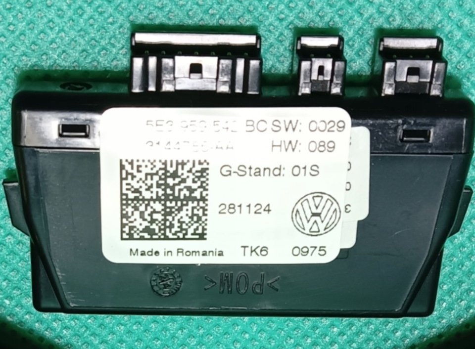

There is new KLR module 0029 in new steering wheels. All steering wheels with 0023 are problematic when steering wheel heating is opened.
Hmm, I haven't encountered this. Have u PN for this module?
Thank u, i’ll order it and check :)
But i dont have additional errors on 0023 if wheel heater is ON :)
There are touch intensity error in module 13 and A5. As you described, klr sensor measured values hits 255 and gives error. Sometimes when I activated TA(set or resume) together with heating, it gives error on dash and I need to push Set button several times to activate again
Maybe its sensor faulty, not module? Or u changed 0023 to 0029 and this bug was fixed?
