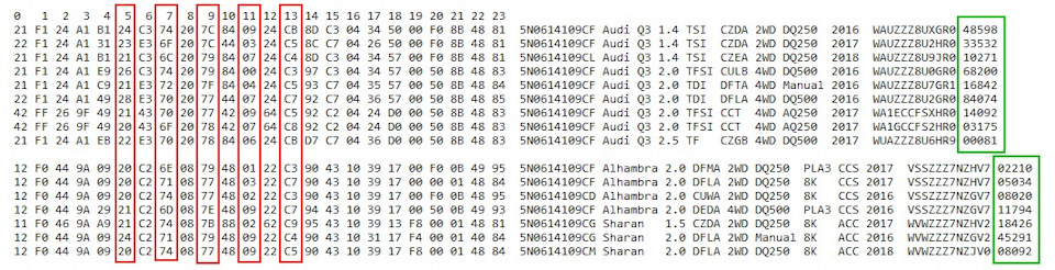

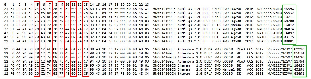

As we know PQ35 platform Seat/Alhambra/Q3 has newer abs than Tiguan which is called TRW460 and has PLA3/RTA/BSD support.
This new abs has long coding which seems hard to retrofit it to Tiguan. But now we can set 7 bytes of all coding according to VIN.
When you look at the example of codings above, (Alhambra/Sharan/Q3) all last 5 digit of VIN fit the coding table below.
Also i think byte 20 is about 2WD/4WD, byte19 is about ACC and byte23 is about Engine.
I hope, someone can solve most of other bytes and we will be able to retrofit it in future.
Then perhaps, retrofiting ACC PQ (7N0907572) will be possible.
What do you think friends?
Download ! : VCDS Label File of TRW460 ABS
TRW 460 8T3,8T5 (With ACC Support)
5N0614109CM
5N0614109BT
5N0614109CC
5N0614109CE
5N0614109CH
5N0614109CK
TRW 460 8T0,8T2 (Without ACC Support)
5N0614109CR
5N0614109BR
5N0614109CB
5N0614109CD
5N0614109CF
5N0614109CJ
5N0614109CL
Example VIN: VSSZZZ7NZHV702210
last 5 Digits: 02210 and 7th: 7 — 8th : N
Byte 01 = F0 ==> 7
Byte 03 = 9A ==> N
Byte 05 = 20 ==> 0
Byte 07 = 6E ==> 2
Byte 09 = 79 ==> 2
Byte 11 = 01 ==> 1
Byte 13 = C3 ==> 0
Coding Table according to VIN:
Byte01 | Byte03 | Byte05 | Byte07 | Byte09 | Byte11 | Byte13
0 = E9 | K = 97 | 0 = 20 | 0 = 6C | 0 = 77 | 0 = 00 | 0 = C3
1 = EA | L = 98 | 1 = 21 | 1 = 6D | 1 = 78 | 1 = 01 | 1 = C4
2 = EB | M = 99 | 2 = 22 | 2 = 6E | 2 = 79 | 2 = 02 | 2 = C5
3 = EC | N = 9A | 3 = 23 | 3 = 6F | 3 = 7A | 3 = 03 | 3 = C6
4 = ED | O = 9B | 4 = 24 | 4 = 70 | 4 = 7B | 4 = 04 | 4 = C7
5 = EE | P = 9C | 5 = 25 | 5 = 71 | 5 = 7C | 5 = 05 | 5 = C8
6 = EF | Q = 9D | 6 = 26 | 6 = 72 | 6 = 7D | 6 = 06 | 6 = C9
7 = F0 | R = 9E | 7 = 27 | 7 = 73 | 7 = 7E | 7 = 07 | 7 = CA
8 = F1 | S = 9F | 8 = 28 | 8 = 74 | 8 = 7F | 8 = 08 | 8 = CB
9 = F2 | T = A0 | 9 = 29 | 9 = 75 | 9 = 80 | 9 = 09 | 9 = CC

Byte 1 and byte 3 are from VIN too
Byte 1 (7 chart of VIN)
F0 => 7
F1 => 8
FF => F
Byte 3(8 chart of VIN)
9A => N
9F => S
A0 => T probably
A1 => U
