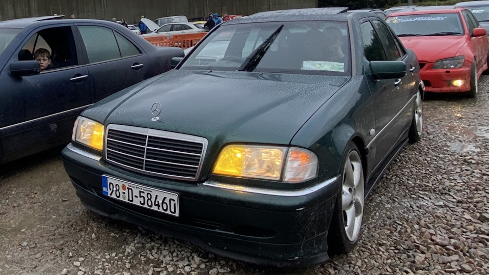

Hi all. I am looking for information on swapping my M111.921 1.8 litre engine to a m111.975 2.3 kompressor or maybe m111.944 2.0 kompressor engine. I want more power in my C180 but I understand electronics may be difficult. I do not want to use a standalone ECU such as RusEFI or January ECU.
My car has Bosch ECU, I believe ME2.1 software. Can I use the engine, ECU, immobiliser etc from a CLK200 Kompressor or CLK230 Kompressor (pre facelift 1996-2000) with Bosch ECU and will it work in my car? I am finding it very hard to get any information on this engine swap. Any help is appreciated.
P.s. I cannot buy a C200k or C230k in Ireland as they are impossible to find for sale.

I have bought a donor car, a 1999 CLK200 Kompressor 193bhp. It has a Bosch ECU and should plug straight into my existing wiring loom. I'll begin the swap in the next few weeks hopefully.
